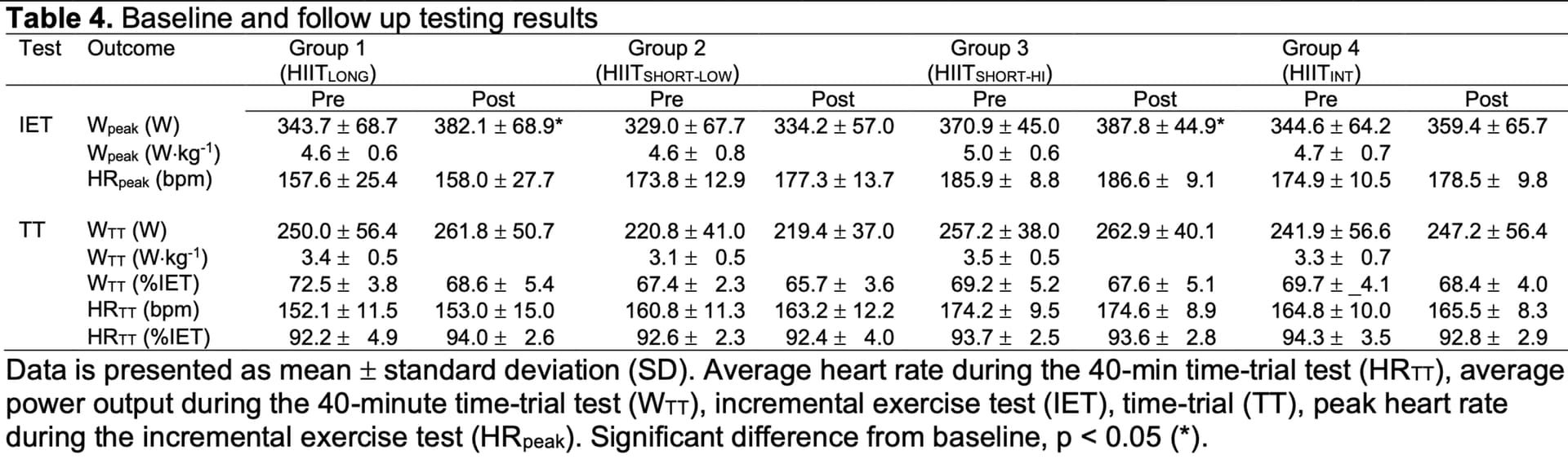

How does the intensity in the table correspond to FTP (roughly)?
From the link to study on Evidence Based Coaching website:
The IET in the current study incorporated shorter stage increments (12.5 watt increases every 30-seconds). Interval work-bout intensity was programmed for each participant at a percentage of the difference between Wpeak and the WTT (15% for groups 1 and 2, and 30% for group 3 and 4); where WTT was used as a proxy for the metabolic steady-state threshold. The group mean power output for WTT was 70% ± 4% of Wpeak. This is consistent with CP and MLSS as shown in previous literature where CP can occur at 67% of Wpeak [17] and MLSS at 70% of Wpeak [18]. The mean power output during the interval sessions for all subjects in the current study was 77% ± 4% of Wpeak (75% ± 3% for groups 1 and 2, and 79% ± 3% for groups 3 and 4).
They used 40-min time trial power - TT in that screenshot - as proxy for metabolic steady state.
If you pull up Table 4:
HIIT work intensity by group, using Pre values of watts for TT (FTP) and Wpeak (MAP/pVO2Max)
Group TT / FTP Wpeak / MAP / pVO2max HIIT Interval Target HIIT as % “FTP”
Group1 250 344 264 105.6%
Group2 221 329 237 107.2%
Group3 257 371 291 113.2%
Group4 242 345 273 112.8%
Check my math, I’m on a conf call and whacked that out.
Summary:
  • about 106% FTP for the 4x6-min (4-min RBI) and 12x2-min (2-min RBI) groups 1 and 2
  • about 113% FTP for the 12x2-min (2-min RBI) group 3 and 16x30/15-sec group 4

Yes. Roughly FTP ≈ Wtt for the group. But lets consider individual variability vis-a-vis fatigue resistance at FTP (time to exhaustion at FTP/CP range ≈ 15-70 min) to put some 95% prediction interval error bars on that estimate. So it’s probably more like:
FTP = Wtt ± 0.5 W/kg
Please don’t consider this advice to use a 40-min TT to predict FTP. There is zero way for an individual to know their precise FTP/CP/metabolic steady state power by performing a single 40-min TT.
But a 40-min TT is a pretty great performance indicator on its own: if it goes up (above some minimum detectable change) then you can say you’ve improved your performance!
Reasonable, but to be clear you only estimated Wpeak (from 30-sec ramp steps) and 40-min TT. I’ve said estimated Wpeak because I’ve seen meta studies point out Wpeak can change based on ramp protocol. In other words, Wpeak-30secRamp can be different from Wpeak-1minRamp and Wpeak-2.5minRamp, is that right?

Group 40-min TT / “FTP” Wpeak / “30-sec Ramp MAP” ”FTP” as %Ramp
Group1 Pre 250 +/-22% 344 +/-20% 72.7%
Group1 Post 262 +/-19% 382 +/-18% 68.5%
Pre vs Post 104.8% 111.0%
Group2 Pre 221 +/-18.6% 329 +/-20.6% 67.2%
Group2 Post 219 +/-16.9% 334 +/-17.1% 65.6%
Pre vs Post 99.1% (decrease) 101.5%
Group3 Pre 257 +/-14.8% 371 +/-12.1% 69.3%
Group3 Post 263 +/-15.3% 388 +/-11.6% 67.8%
Pre vs Post 102.3% 104.6%
Group4 Pre 242 +/-23.4% 345 +/-18.6% 70.1%
Group4 Post 247 +/-22.8% 359 +/-18.3% 68.8%
Pre vs Post 102.1% 104.1%
Not only is there fair amount of variance on 40-min TT (FTP proxy) as %ramp, there is considerable variance on group average TT power and Wpeak. Had to ignore all that and using averages as I don’t have data per individual.
Looking at that its hard to not think hard about the logic of using a 70% multiplier to estimate FTP from average watts of last step in a ramp.
What if the participants used ramp’s 70% of best last step power to pace a 40-min TT? Would it matter in practice? Group1 data:
  • group1-pre average of 344W * 70% = 241W target for TT, while they actually did 250. Target about 4% too low.
  • group1-post average of 382W * 70% = 267W target for TT, while they actually did 262. Target about 2% too high.
Its ok as a rough guess at TT pacing, but without the TT effort it looks a little like a random variable around a mean. Somewhat like I would expect from the % data seen using a TT and ramp.
If you don’t have a lot of experience training, or doing TTs, there is absolutely a lot to like about coming up with a rough estimate of FTP as first pass at setting zones, training around threshold, and pacing a longer 40-min TT.
yes, and my point-of-view is that you can learn a lot from it (or any long TT effort over 30-min) because its basically a similar effort as to one that’s at your current FTP / metabolic steady state.
