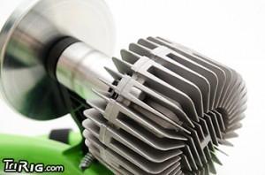

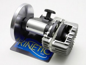

It’s a fluid resistance unit with a sealed chamber. They use a special fluid that doesn’t change in viscosity as it heats up. This is what makes it kick ass for VirtualPower.
The sealed chamber has a disc in it. When that disc moves, it has to overcome the resistance of the fluid. That’s what creates the resistance while you workout. The nifty thing they do is that the fluid chamber is completely sealed. They use magnets to connect the drum that you’re moving and the disc in the fluid. That’s how they guarantee that it will never leak.

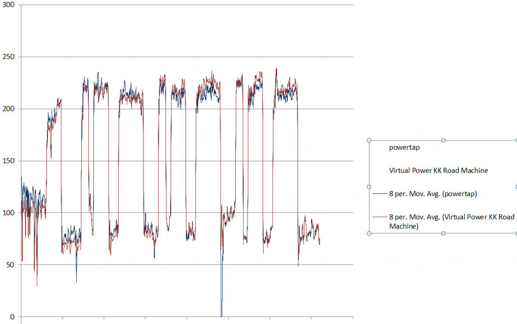

Kurt Kinetic Power Curve vs PowerTap (no offset)
Here’s a workout I did with my PowerTap, which is a power meter that claims +- 1.5% accuracy. The blue line is the PowerTap power and the red line is our VirtualPower which is calculated from speed.
For this setup I used a continental trainer tire at 120psi. I cranked down my rear wheel 1.5 turns.
You can see that VirtualPower tracks really well with actual power. Although VirtualPower is higher the entire ride.
This due to rolling resistance between the tire and the Kurt Kinetic drum. We call this difference the y-intercept offset.

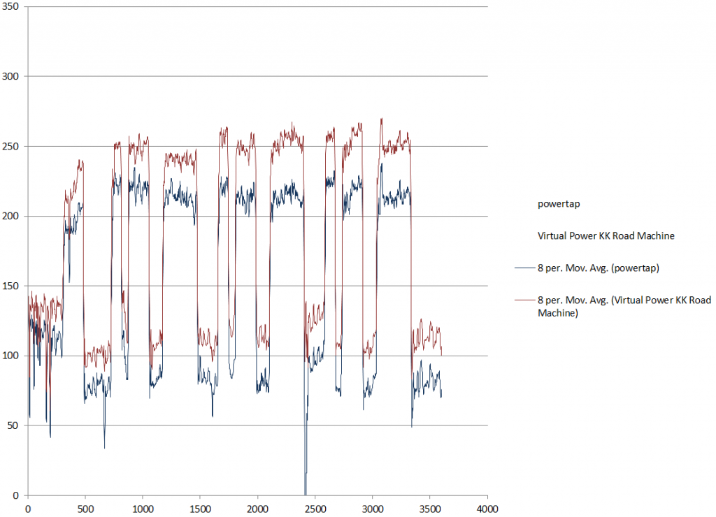

Kurt Kinetic Power Curve vs PowerTap (Adjusted Offset)
I threw my data into excel and changed the y-intercept offset by 30 watts. When I did that, BOOM, VirtualPower and Power lock in. There’s a little bit of difference in the first 5 minutes which I think is the rear tire heating up. But after that it’s really close. So close that the +-1.5% accuracy of the PowerTap makes these results even more compelling.
What does this tell us?
This tells us the Kurt Kinetic Road Machine works really well with VirtualPower. I did the above test with the 3lbs fly wheel (blue model). I talked to Kurt and they tell us that the power curve doesn’t change between the 3lb, 6lb and 12lb models.
