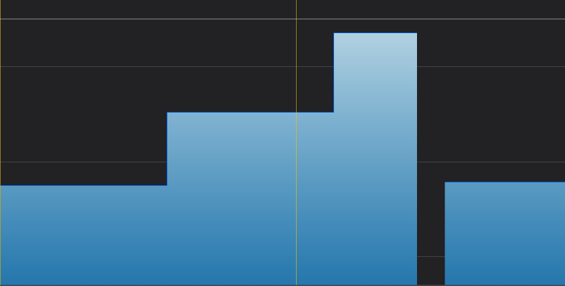

Example of power-based LSCT
Nuts & bolts aside for now, I’ve taken certain liberties and done my best to effectively translate percentages of maxHR to power outputs in a such a way that we can use the LSCT as a straightforward warmup but also gain some insight into our personal Heart Rate Recovery (HRR) & HR response trends and what they might tell us when it comes to recoverability.

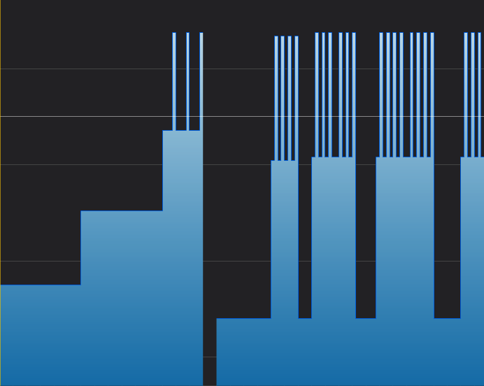

LSCT- HIT modI’ve even modified (more liberties) the warmup to include some short, workout-specific, brief but intense warmup efforts in some of the more difficult HIT workouts because I realize many riders will be more intent on getting adequately warmed than tracking levels of fatigue & freshness. But in either case the format is basically the same:
  • 6 minutes at 50% FTP at steady RPM
  • 6 minutes at 72% FTP at steady RPM
  • 3 minutes at 96% FTP at steady RPM
  • 1 minute of sitting upright to watch HRR
So as you can see, the standard LSCT doesn’t even have riders reaching FTP but it’s enough of a workload to elevate the HR to a point where the final, non-pedaling (works best if you’re not using cadence to play/pause workouts) minute of the LSCT can be very telling.
The modified version has some short efforts that will affect your HRR so feel free to pull any workout into our Workout Creator and lop these suckers off if you plan to routinely use the LSCT in its more scientific manner.
